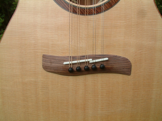

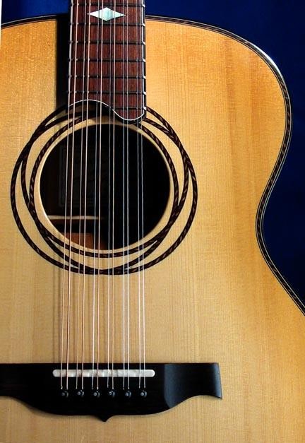

Craig,
Howard Klepper gave me the answer when I was making my guitar-cittern that had 5 pairs of strings. Drill 6 holes and put two strings per hole - slotted bridge. You use the ebony oversize 5 degree bridge pins that Stew Mac sells. This is the picture Howard sent me (hope he doesn't mind me posting it):
And this is what I did on the guitar-cittern:
PostPosted: Tue Jul 10, 2007 10:02 am
Posts: 720
That's some great work Dave ( and Howard too , of course ) . Thanks for your post.
You may remember I wrote you about shared pin holes some time back . The concern was how long will that little nub of wood (between the string pair ) hold out.
It is very small and has half the force of two strings pulling at it , and a lot of wear from the two string balls which must be near touching each other.
Now that you have had yours strung up for some time , what are your feelings regarding this ?
Regards, Craig
CRAIG LAWRENCE of AUSTRALIA
PostPosted: Tue Jul 10, 2007 7:54 pm
[QUOTE=KiwiCraig]
Regards, Craig[/QUOTE]
Craig,
I can't really comment as I haven't seen Gavin and the guitar-cittern since he collected it last September. I thought that the whole point of a properly slotted bridge is that the wear on the bridge plate was minimal as the ball ends fit properly and don't move around at all - you can take the pins out under string tension and the strings stay rock solid put. Also with the 12 string you have octave strings so the slots are narrower than on the unison paired guitar-cittern I did. Cut carefully and properly with a good hardwood bridgeplate installed and I think it will be fine.
Best way is make yourself a 12 string as a test model (good excuse huh ) and see how it goes. If I were to make myself one I would do the double string per hole.
